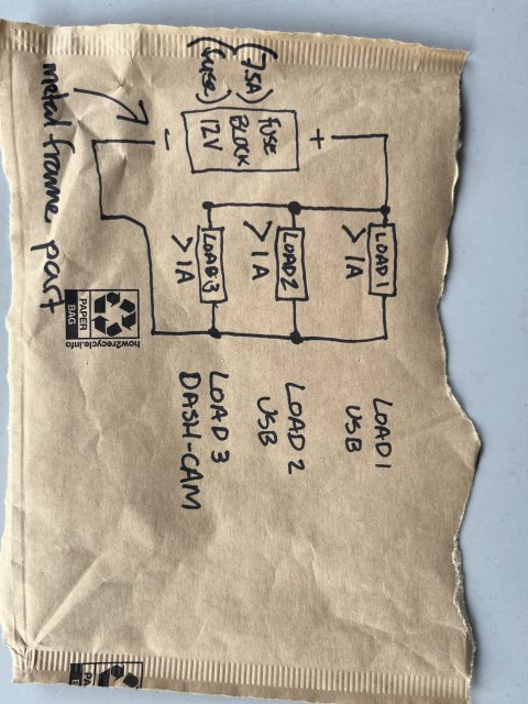

I have 2 circuits that I want to add to the car.
1. for the dash cam. It is currently in the cigarette lighter which is always powered, so it needs a new point of connection.
2. for a pair of aftermarket USB ports. Total maybe 20 watts at a time.
Both circuits should only power on when the car is on.
I prefer easy, but even more so, I prefer to do the job just once, the right way.
I understand that running 2 new circuits means putting a fuse in line. If I do it this way, do I go direct from the battery?
All tips and pointers appreciated. I'm an apprentice electrician, so I understand a bit and looking for an intermediate explanation if there is one.

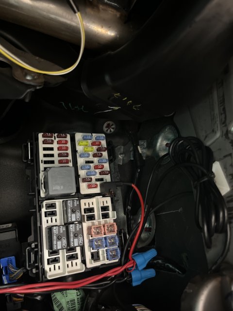

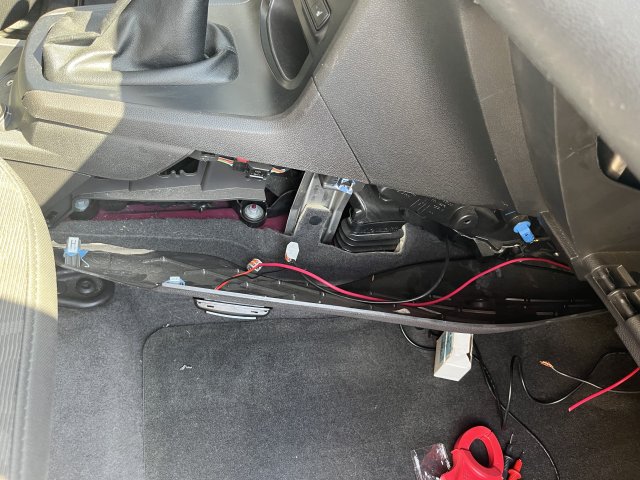

If the other circuit is going to be a continuous feed I would just use a soldered connector from the battery and feed it into the cabin through the access point under the a pillar window. There’s a body plug visible when you open the door. I ran a good sized cable through it and back to the cargo area to run a 2000 watt sinewave inverter and also a 12 volt power point to run an onboard air compressor. The power points that are in the center console are not rated for anything but a phone charger. I did add a switch and inline fuse back there to prevent issues. I can add some pics if you want them.
