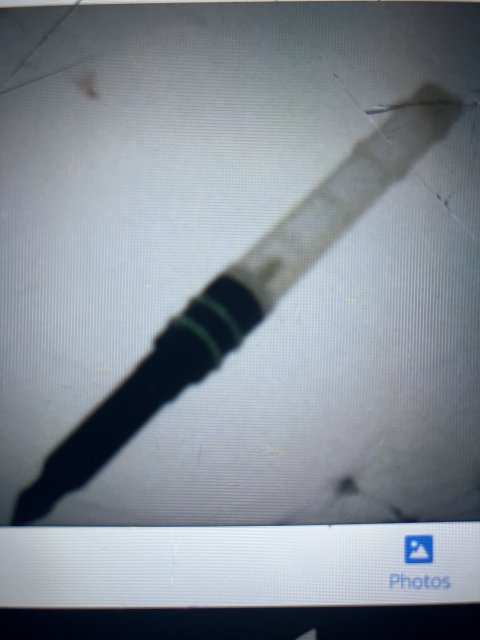

Anything that causes a restriction could have the effect of causing the system to shut down. Possibly the oriface tube has broken or become clogged with debris? Unfortunately the refrigerant has to be purged and an inspection performed. Keep us updated on what you find out.
It’s a a poor image. But, I am putting my money on the problem being a failed or obstructed oriface tube.
