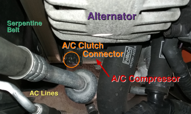

If the Starter is OK, you may have bumped or cut the wires to the A/C clutch - check the fuses and inspect the wiring to the AC clutch - the Loom it is in - make sure you didn't inadvertently cut or pinch a wire in the harness going to the AC clutch during your installation.

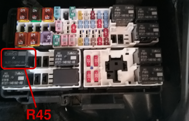

In the Engine bay, the Fuses are F41 (10 amp RED) and F26 - which may be either a 7.5A (blue or amber) or 15A - check your owners manual for Fuse location and numbering at the time that car was made. It can change thru the years this vehicle was made.

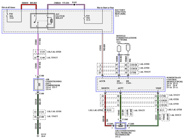

  • Example, the Schematic I have - shows power that goes to the Clutch uses F30 - but my owners manual claims it's Fuse is F41 while the "means" to power its' relay-coil comes from another Fuse that goes to the Powertrain Module in the Engine bay. That fuse is F24 - if it's blown it can affect more than this AC unit - it may power other Relays (see S163? - That means the wire to that Relay is SPLICED in from another feeder wire in the area.)
Here's a working schematic of the AC Clutch relay and wiring - note and pay attention to; and verify, the color codes
Relay R45 is your AC clutch relay.
Again...Check Relay and Fuse Numbering in your OWNERS MANUAL

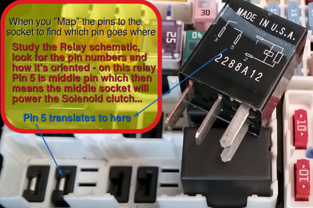

To see if the wiring is intact, don't Start or Run the engine - leave it Off. Just use any DVM in the 200Ω Ohm setting and pull the R45 Relay - locate it's Pin 5 and map it to your Fuse-block - then place one Tester lead in the slot/Hole in the Fuse block and the Other to battery Ground Post - see if you can complete the Circuit - should be less than 60 Ω in resistance - but not ZERO or lower (Less) than 5Ω (You may see 4.7Ω but that's OK, just not ZERO or dead short stuff - less than 1 ohm)
If you get no readings, make sure you did pull R45, and look at it's "Schematic" or pin-out diagram if it's still legible - the Relay should have a schematic or Pinout design to show which pin does what in the Relay...
If it shows a short, the Loom it's in needs to be inspected - if it's open - same thing but look for breaks in the wiring loom to help locate the internal break.
