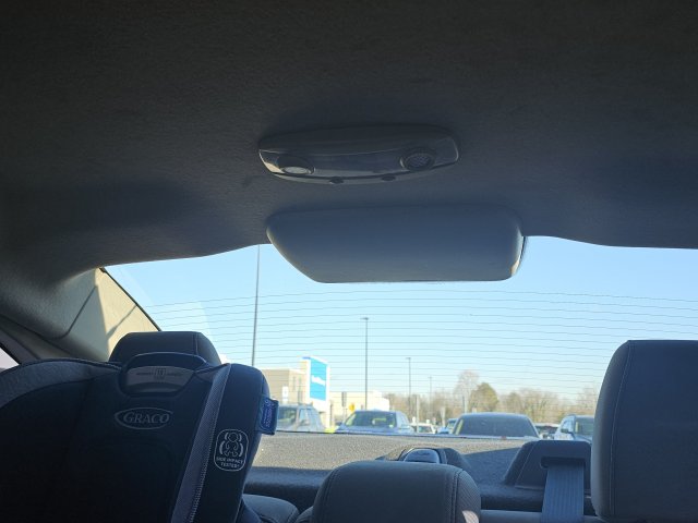

Hi newb here. My daughter's 2018 US Fiesta sedan needs a 3rd brake light bulb. The videos on YouTube all show removing screws to get the housing out. Hers doesn't have any screws. Can someone confirm it should just pop off? I'm putting a little force on it but don't want to break it and it's not coming off. Thanks in advance for any help!
Please post a pic of what you're up against...
Because of several directions this could go.
Mostly that the housing takes the place of a trim rivet on both sides of the housing.
Huh? - so in a hatchback, it would have two rivet fasteners to hold that rear upper cover - one to each side of the housing that the 3rd brake light is.
That is, for a sedan. The trip pieces this thing is has changed thru the years so one range of earlier models needs a screwdriver tool, while another needs just a simple plastic trim pry tool instead.

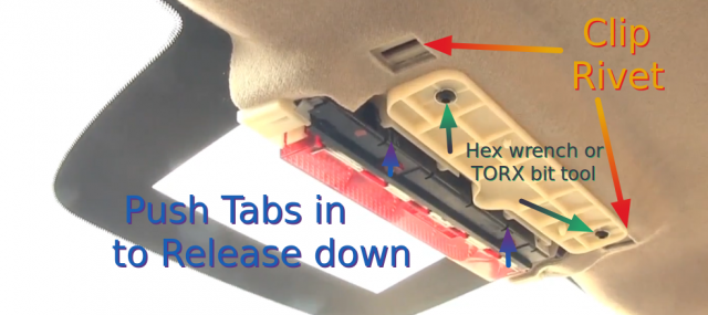

Did anyone find a fix for this? My top or third brake light is half out and i can only find ways to fix my tail lights. My housing is inside the back seat on roof and i cant figure it out. Ford fiesta se 2013

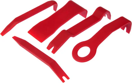

You will need a pry tool..

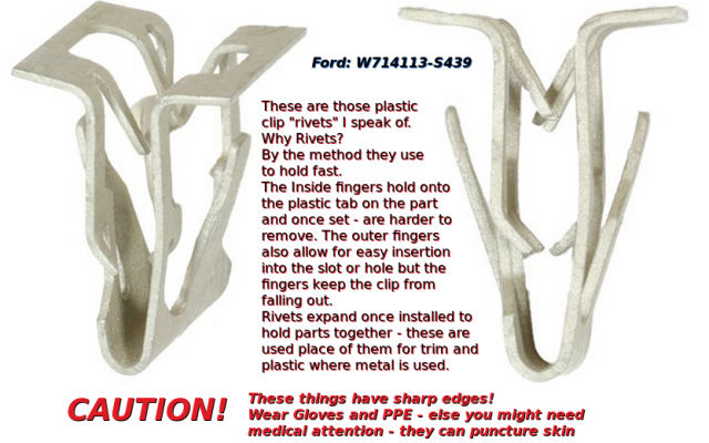

On the Fiesta - any base model - it uses "plastic rivet" clip - wide-head to hold the headliner (and in this case your 3rd brake light) to the interior roof. That big wide RED (or any color of your choosing-pick by outline) ones are the best. Their wide surface area lets you apply some gentle force and multiply it over a larger surface area so the trim and felt doesn't look funky when it's reassembled.
Plastic Rivet? They are made of metal and clip onto the Plastic tabs on the pieces and fit the slots - you will have to pry these out carefully so you don't break the tabs or bend the rivets to pieces and shred your work. I Strongly advice using PPE to protect yourself from getting cuts and bleeding their design can cause. By their shards and sharp edges they can form once removed. The metal spikes - they can deform and can be considered "SHARPS" (READ: Puncture - SEE: Needles) - you may need to order more newer ones to replace the older ones - if they are too deformed - just discard them - properly and carefully.
So you will need a pry tool; trowel or putty knife to help release the rivets carefully - you rock the tool under the plastic trim and the headliner - to help release the rivets from their threaded (or slotted holes shown below) holes - work one side to pop its rivet - then work the other side to pop the other clip-rivet.

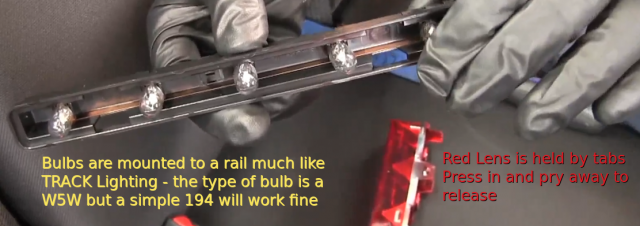

To remove the lamp itself - two tabs one either end
are pried to release the lamp and lens TOGETHER

To hold the interior headliner - they are simple plastic pop-rivets no metal is used,
They fit and go into those TORX/Hex Key holes just aside the outer seal gasket.

It's best to buy at least 6 bulbs (8 ~10 come in a case keep rest for spares) and replace ALL bulbs
Reverse procedure - re-clip red lens and reconnect electrical connector and reinstall...
CAUTION: best to do a TEST to make sure all those lamps work, else you may need to
re-form; pry or clean the contacts on the lamp assembly to help re-establish the light so it works.​
