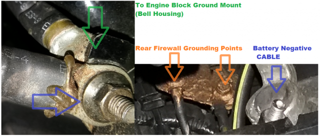

Just keep the Battery and Ground Lug terminals that bolt to the body, - in good shape.
No corrosion = Problem Free Operation
