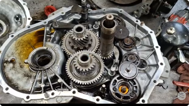

DSP 6 Guts...
Including how the Actuators take place of the clutch pressure plate and it's application of pressure - this case the gearing uses the actuators to not only find the gear using the TCM - but the stepper motors themselves are working in two different events. One in finding the gearing - the other; the pressure in incrementing the gear to apply the force needed to position and engage the gear onto and mesh the teeth of the other gears.
You'll notice there is something like a watch factory going on inside the transmission too. The actuators use the watch-type of gearing to reduce the stepper motion into a more pressure applying force to move the gears - so the zzzz-it, zzzz-ip and zzzz-at the actuators do - apply and moves the transmission gears in increments by using those multiplier gears - not as smooth as manual clutch to plate as per a humans senses to feel the tug and grab and move the foot to affect the pressure on that clutch place. But having lacking that touch - the TCM works using the ECM's control inputs thru the speed sensors as well as engine RPM and several other tricks of; fuel to air ratios, the Cam advancement as load feedback as part of it's tool box because of the level of pressure-by the application of the multiplier gearing to reduce the steps into a gradual slope of pressure - they do most of the job without causing excessive wear - in most environments.

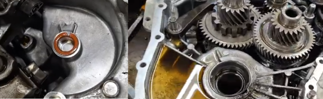

The above photo is from a YT user thinking they had worn a differential bearing - however due to the overall wear of the transmission. Following the owners manual - the lack of fluid changes that let the transmission wear evenly; comes at a cost. Being? Of now the lack of changes for the fluid then lets those suspended particles wear down all components involved which will add a level of slop that now goes beyond tolerance and so you have the "grabbing" issue. This is not just about the moving parts but in the video - it is also shown as a part of the transmission housing CASTING that can limit the service life and require a replacement - so by driving habits as well as the level of torque applied, can drastically shorten the service life of the transmission. Be sure to look for the Magnet the transmission (any of them) comes with. The level of particle suspension in the fluid being ferrous metals - can be attracted to the magnet and stay, but its also the non-ferrous metals and materials used (brass as well as other media like; coatings and aluminum of the casing itself) that add to the contaminate suspended in the fluid - increasing wear.
You can review the troubleshooting this user did by viewing it here.
  • Be sure to watch the related search videos too - they can provide more insight to how the mess is created and the steps needed to fix them. It - may make you reconsider how hard you drive and what you do to purchase a new vehicle and the trade offs in choices that you have to make.
