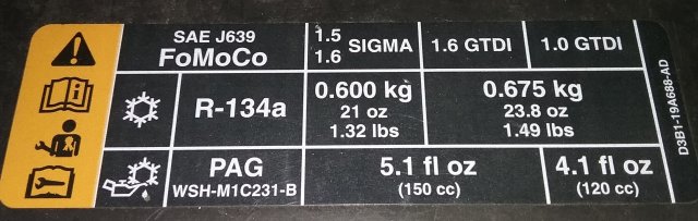

Hello. Do you know how much PAG oil to add to the condenser when replacing(new part has the dryer attached). Mine took a rock hit. Thanks!

It's not how much, but more of the "Volume" the gas you are replacing it with.
When you take on a Rock hit, that usually means the condensor unit - the outside one, that got hit, is compromised and that part of the system needs to be replaced.
So if you got that done, the rest is on the sticker on the front cowl.
The above is for a FORD Fiesta 2019 vintage...​
I just have to caution you, because part of that "volume" be a lubricant to keep the bearings in the system working and not seizing up.
It (the lube oil) is supposed to be in a suspension in the can of refrigerant you use and is supposed to be compatible with the PREVIOUS refrigerant that was used in the OEM system. So that when it is dispensed out of that can into your system, it will have the proper ratio of oil to refrigerant - so shake the can well, and add some before you start the motor, to check for leaks - then there should be enough in the system that once the compressor starts - with won't lack fluid and lube.
Check with your own manual and always work with the instructions that come with your replacement can of refrigerant.
Then see if you can add the can into the system with the engine running with the blower and AC on (including that button getting pressed in at intervals - you may need a extra hand to punch that AC button on occasion and watch to see when the light will kick on), else they (your helper) will have to "trigger" the AC button as you add in the can while they see if the system can see the pressure change - increase - so the system can turn on that AC light. By then you should have used up most of that can (see sticker above) and you'll hear the compressor work once there is enough - but don't overfill it because it will shut down if you put too much in.
