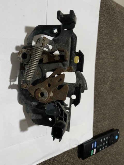

I purchased a hood latch assembly from Quick Parts for my 16 Ford Fiesta SE. They said the part they sent was correct based upon my VIN. The old part (pic attached) has a connector on the left side to the inside, facing the engine. The new part does not have a connector. Installed the new part. But because I didn’t connect the connecting wire to the warning system, the hood open warning light is lit on the panel. The company had 2 parts: non anti theft and anti theft (that had the connector). Does that mean I have an anti theft system or a hood ajar sensor. Are they the same thing! The part numbers are different. Confused when they show anti theft vs non anti theft in the 2 parts description 2D3F0489-A884-4C52-B39C-8ECA2F713AC1.jpeg

So, the issue is the PATS system - if the VIN is ok, they don't have to find you a switch, you can short the wires together. but I'm curious about the Hood latch numbers - because the switch is plainly seen in the photo - with the connector - don't know why they'd hassle you on this...
Does the new hood latch have a way to transfer that "cherry switch" to the new one?

No. Here’s the part I installed, which doesn’t have the connector for the sensor cable to the car

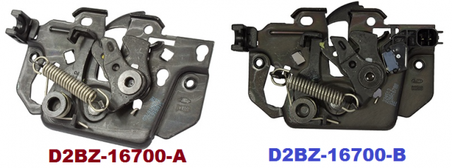

The part recommended by Quick Parts if the car has anti theft. Which looks like you need as long as there’s a cherry switch

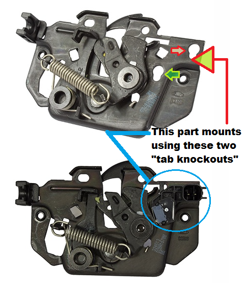

Since I am a "tinker-er" - I can also show with pretty much assurance, that the OEM latch would have surrendered the old switch allowing you to put it on the new one - but that too has older equipment and the reason you got "HOOD AJAR" alert is because the built in switch failed so you needed new and you have to pay the stiffer (higher) price for that part - but I wanted to point out that FORD's own apples - like any other Car Maker - do not fall far from their tree.
They use the same stamp plate for the Backing and mount - but use a plastic "clippy" thing to mount the switch. The Cutouts are present when they stamp it - doesn't affect performance of the hood latch - just gives the stamped plate part a longer life span in stamping so they can add in a switch without too much hassle.

I did see part “-A” didn’t have the sensor but part “-B” did. My gut told me to order “B” based after viewing the old part but I blindly followed the specs on the site (non-anti theft). You can’t call Quick Parts to ask questions. The customer service recording says to use the website.
