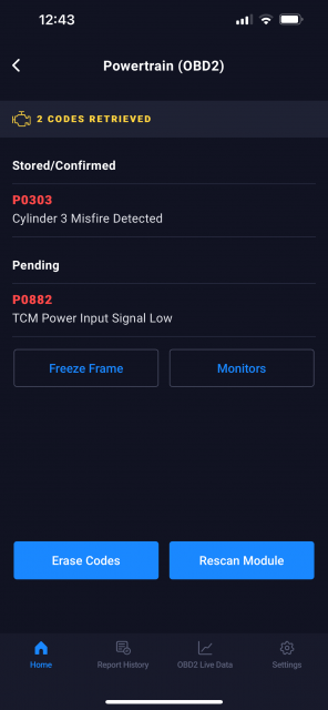

Hello all I’m new hear and I need your guys help. I have a 2016 Ford fiesta S and it will not start. The obd code is P0882. The battery appears to be good. When you try to start the car nothing happens, the car does not crank or click. The radio and the lights all work fine. I already changed the ignition switch on the back of the key cylinder. I checked the fuses and they appeared to be fine. Im thinking that it could be the tcm but im not 100% sure. Your help is appreciated.

Did you try Google the code? - "2016 Ford Fiesta DTC Code P0882"
  • A DTC code P0882 on a 2016 Ford Fiesta indicates a "TCM Power Input Signal Low," meaning the transmission control module (TCM) is not receiving enough power from the engine control unit (ECU), likely due to a problem with the wiring, battery voltage, or the TCM relay itself.

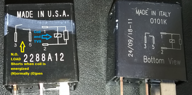

IF not that then the Start Inhibit Relay may need to be looked at and checked for burned or pitted contact - check with a simple ohmmeter across the terminals for the power side while engaging the coil - anything over 1 ohm means the contacts are pitted and the relay should be replaced.
