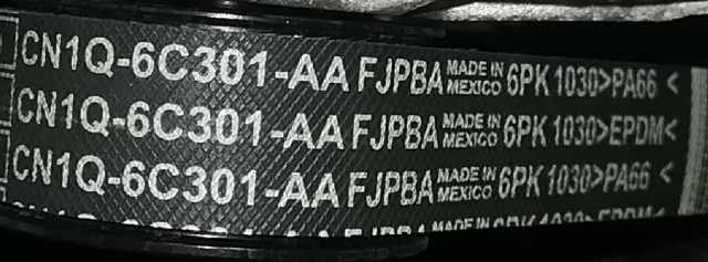

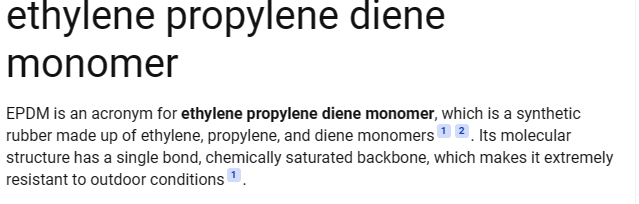

The Belt is a stretchy EDPM type (Extremely Dense Polymer Material) (Actually its' EPDM)
so it would be "derailed" to get it off - then rerailed to put it back on, I mean that it has no "snugger or tensioner" it's on for it's life and you change it - which may be all that this is.

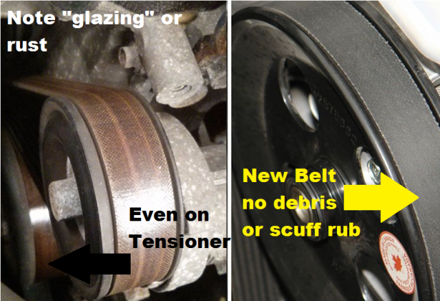

So if it's over 50K or you don't or can't even remember if this has been done before - the good rule of thumb is to replace the belt - for age and hidden failures are possible even within the webbing of the belts own groove and teeth it uses to hold itself onto the pulleys. The older it' is, the Shorter the Length of Time In-between Failures.(Mean Time Between Failures or MTBF) - so best to use the process of elimination and just replace the belt if the belt is bad or has glazing on it - from a stopped pulley, then more than likely it also indicates a dragging or friction on the system when that did occur.
You'll have to find it under, in the grooving, or above on the flats - and see if any shiny spot had developed, then try to fit the clues to the facts - being if it's shiny on the top, the water pump - if it's scruffy and broken up on the bottom, the AC or Alternator (look at the length of scruff - long = AC - Short = Possibly Alternator)
With the belt off, you can then see if you can turn any of the open pulleys by hand any scrub, rub or squeak, even a groan or wobble - would mean the part needs replacement.

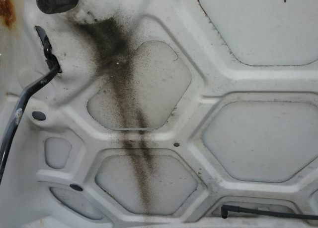

Ok, if a picture is worth a thousand words.
Then to see this as what I'd call - The "Book"
We'll start with the Cover...
IF you have a squeak - then not only do you check the engine and belts - did you even bother to look on the UNDERSIDE of the hood?
Whatever gets thrown around inside - that squeak may be from many things - start your investigation by looking under the hood, literally...

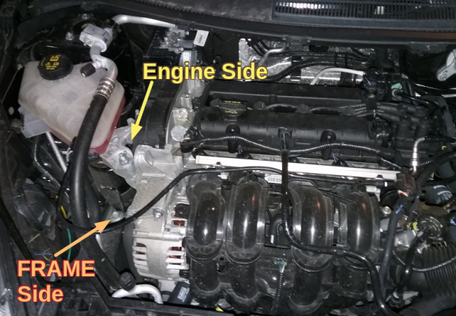

@cedrica - Thank you for the Follow up...
The "Motor mount" was one of the first you described, glad to know you stuck with it and found out that it was those mounts.
But it begs the question...
How did it get so loose?
And...Which Side of that mount was the loose side?
I only ask to help others in the Future with noises that you cannot simply explain...

Hi Andy
The frame side, the side that's on the body of the vehicle, thank you for your advice and time, it is greatly appreciated
