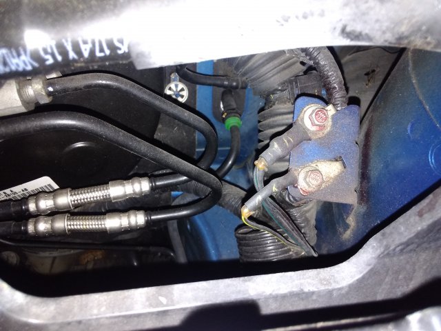

Sounds like a bad ground. Or possibly several. If you look in the engine compartment, on the frame rails near the strut towers there are clusters of wires that are mounted by screws to the body structure. Those can become damaged or corroded to the point that systems stop functioning.
This cluster of ground attachments was the easiest to just snap a picture of by opening the bonnet. There are several other places under the Fiesta where these critical connections are located.
A smart owner would spray these areas with penetrating oil and then apply some grease over the areas to protect the connection from moisture and corrosion.

I also like the idea of applying good old fashioned Vaseline petroleum jelly to the cleaned and refastened ground connections. If the connection is protected from exposure to the air, it really slows down the whole corrosion problem.
