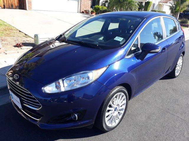

Here she is, her name is Mudkip and I have had her for about 2 months now! I have done a lot of research and I believe it might be an ST line(it is Kona blue), due to it coming with 195/50R16 from what I have seen there are a few different models and setups so please correct me if I am wrong. Main question for me is can a 205/50r16 with a 40mm offset or a 205/45r17 with a 38mm offset would fit with out any spacer or rubbing. Also if the fiesta ST stock exhaust would fit and by chance if anyone has one for sale? Thank you!

Yes, a stock ST exhaust will fit from the Cat on back; not sure about the Cat, though. As far as finding an ST exhaust, I have seen them on EBay and ST forum. Post an ask there and watch the for-sale block; they come up occasionally.
Your question on tires depends on wheel width. A 205/45/17 will likely work unless you put it in an 8-inch wide wheel. I would pose this question to the ST forum, as well. There are quite a few threads about just this subject.

The ST line was only sold in the US in '19. It has the ST bodywork, exhaust, Titanium trim and 16" wheels, but is otherwise a standard Fiesta. I think they were just getting rid of ST parts before closing down the line. Kona Blue was only offered on the Fiesta in '16, so it's a rare and very nice color. The Titanium came with 16" wheels.
You might get away with slightly taller tires, but I wouldn't risk it.

I sold my stock ST wheels to a member on this forum. They're 7x17 wheels, and they fit fine. You can find ST size wheels and the occasional exhaust for sale on the ST forum, like Lions Tooth said. https://www.fiestastforum.com/
