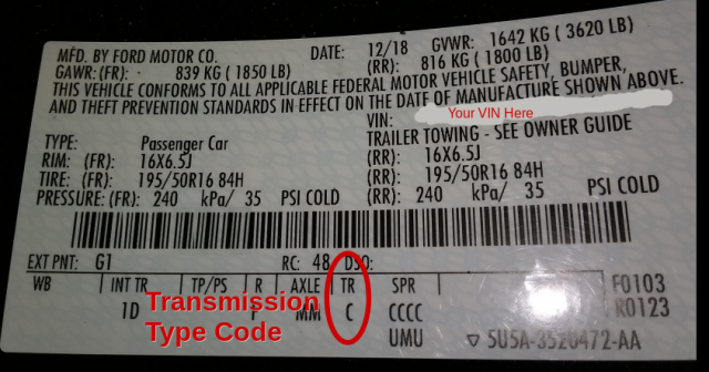

Check the placard on the Door panel - there is a part of the VIN certification label that tells of the type of transmission it would have...
