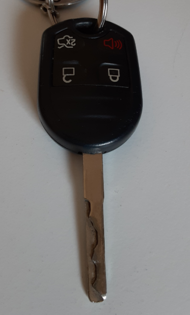

Just bought a 2015 SE HB that only came with one, four-button, key/fob. How do you go about getting another...dealer...other places...it seems that you need 2 keys to get one new key to work? Help? I hate not having a spare.

All the non perimeter sensing keys are a "milled cut" type. So,that aspect is very specific.
I never had a problem with programming the remote functions in past ford remote keys. But you will definitely need to have both keys near the car when the new key is cloned to the car.
The dealership parts department will require your VIN to order a new key.

Yeah I only have one, so it looks like I am going to have to bite the bullet and pay the dealer.

Got my key...$268 from the dealer...happy now.
