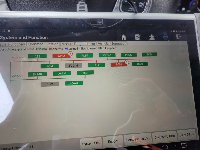

I have a 2015 Ford Fiesta Titanium Has 43890 miles , I owned it 2 years
Here is what am dealing with

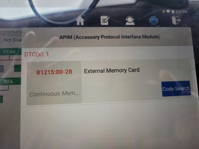

Battery not getting a positive reading on Scanner, but checked on my other vehicle getting a +13 on scanner
Battery Voltage Codes
U3003:16-08 Battery Voltage Continuous Memory DTCs
U3003:16-28 Battery Voltage
U3003:16-88 Battery Voltage
U3006:16-08 Control Module Impute Power A Open Circuit HVAC
U0164:87-08 Missing Communication with HVAC IPC Instrument Panel Control
UE003:00-08 Ignition Input On IPC Instrument Panel Control
U300F:00-08 Ignition Input Accessory IPC Instrument Panel Control
U0423:00-08 Invalid data received form Instrument Panel

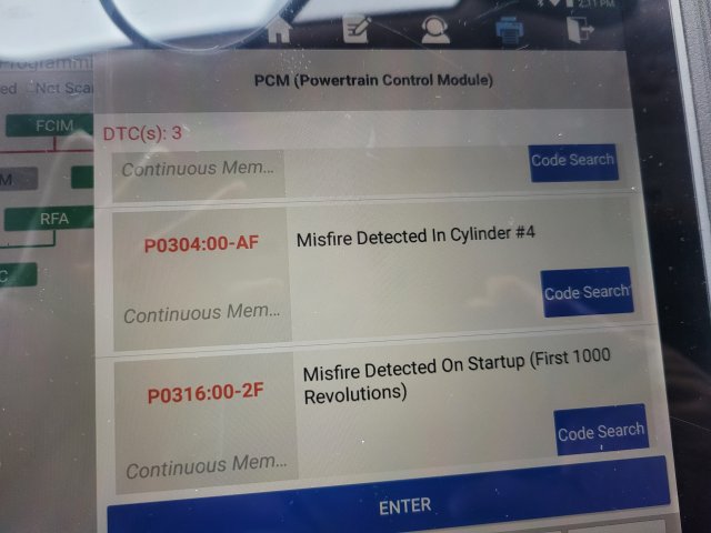

PCM Codes after first engine Start
P0172:00-EC Too Rich System Bank 1 -- Red
P0301:00-AF Random Misfire
P0301:00-AF Misfire Detected in Cylinder 1
P0304:00-AF Misfire Detected in Cylinder 4 --- Red
P0301:00-AF Misfire Detected on Startup
TCM codes after Engine Restart
P0702:00-28 Transmission Electrical system Fault --- Red
P0882:00-28 Transmission Electrical system Fault – Power input low Signal --- Red
I deleted all error codes and started the car and ran it for 35 minutes no error codes or no check engine light came on. I turned off car waited ten minutes then restarted fiesta and check engine light came back on. Rechecked codes and 5 fault codes were detected (They are underlined in red).
I also took screen shots of the codes see attachment files. I looked for battery sensor it was not located on battery cable (negative). Does this 2015 Ford Fiesta have a battery sensor? I tried to find it using my vin# but keep getting same message – No information found check vin# resubmit information. I checked this on Fordparts.com. Has anyone run into anything like this
