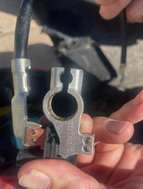

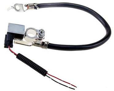

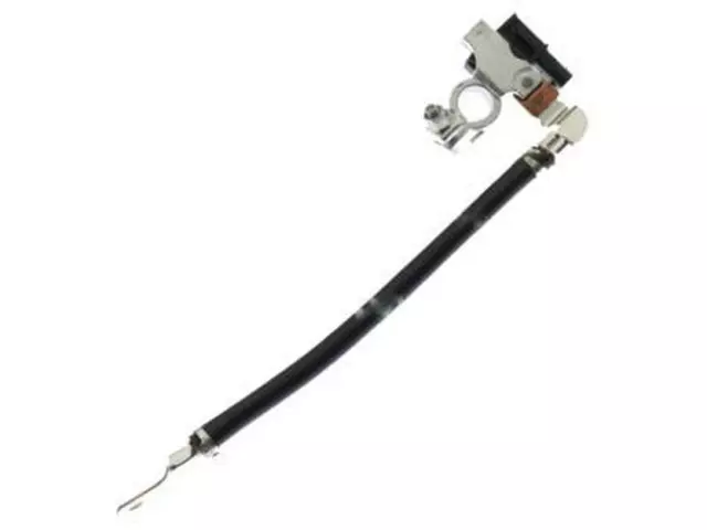

To add another twist to this - you may also (since you own a Titanium-line Fiesta) you may have a type of Battery Ground Cable that "disconnects" everything...
Looks like this - and you'll have to open the Hood and check for this type of cable...
This cable contains a device that when it's hooked up to the harness and to both the NEGATIVE POST of the Battery and the GROUND BOLT on the vehicle - they form a circuit that if the vehicle feels it's been tampered with or otherwise senses a battery drain failure that is severe enough to force an event it thinks can destroy or prevent the car from operating properly - the "Solid State Switch" the cable uses to conduct current across it, turns on - preventing power from flowing across it and prevents the system from using this cable to return power back to the battery in the event something catastrophic were to occur - it's an MOSFET used as a SWITCH to turn off Ground to prevent any further drain on the system.

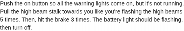

A Battery Monitor Reset needs to be performed if you replaced the battery - this procedure I have not tried for I do not have a Monitor system ... you're on your own.
Basically put the car in Intention; to Ignition On, but not START so the engine does not run during this procedure.
Once this procedure is complete, just turn off the ignition - let the car "power down" as per the reference the "Watchdog" goes back to sleep then hit the keyfob to unlock the doors and you should be OK to continue.
