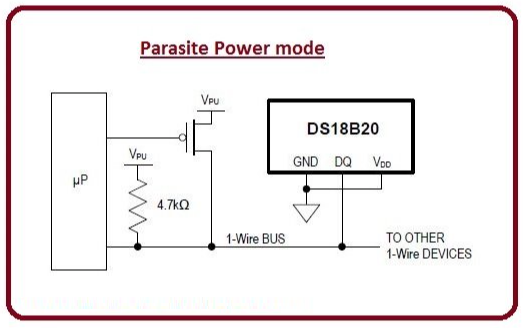

The above is a type of temperature measurement of a system and stores data serially and can supply information upon request.
https://www.theengineeringprojects.com/2019/01/introduction-to-ds18b20.html
It might be bit beyond the scope of this forum, but the concepts used in this device can help explain how the DTC and CAM bus system and it's utilization of callout addressing can be used as a method to add on systems that can be called upon to augment the cars ability to use features and supplement features with enablement's that are not unlike the added features of a trim line - like S to an SES for example.

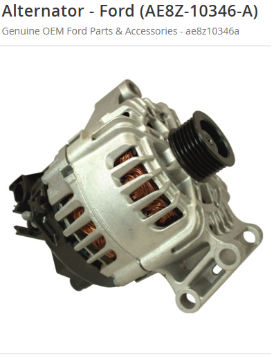

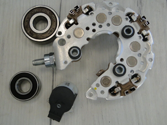

Alternator Rebuild Kit for Fiesta, Cmax e&c...
Although rare, it does occur, the alternator - having carbon brushes, slip rings and a built in set of coils, stator and rotor - it is not too uncommon for the coil winds to start building up debris and even have it's enamel dielectric begin to break down. . As you can see by the above, the main "guts" are integrated into a single unit - but that does not fix the main problem of bad coil or winds that have shorted - in those instances, you'll just have to replace the whole mess with a new one.

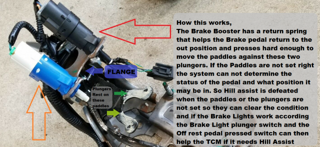

1,849
#16
This may also indicate something to do with the Fluid Level the Brake Fluid is.
That will set a BRAKE and even a Symbol light on the DASH if it thinks this - so if it's not on yet, lets see if the Brake Pedal needs a little tweak.
Pumping the brakes - the actuator is in the center hump - and a key solenoid that runs to the TCM to power down IT'S OWN actuators is in this area too. The TCM uses the PCM and BCM (Body control module) to help control the transmissions own gearing - where to start out at, what gear it's in, how fast the wheels are tuning to help select the gear and the Brake pedal to tell the TCM not to accelerate and even offer to coast the car (or Engine Brake) to lower it's speed versus keeping the car in gear at any given speed.
So the keyword here is how much plunger action is needed?
The brake pedal assembly rests in a carriage - it holds the switches which you see - held on one flange of this assembly, the "pedals" that affect it - are on the Brake Pedal itself.
So if the FLANGE the switches are resting on, is not set right - those plungers may be set out TOO FAR and the system can't acknowledge the Brake Pedal position is correct. (It can't determine if the Pedal is; in, out, or somewhere in between)
So if the Brake lights are off, when the Brake Pedal is at rest - the plungers may need some simple alignment or may be going bad or adjust the Flange so the paddles meet and press in the plungers for those switches to tell the SYSTEM where the Brake Pedal is, then the TCM actuator that lets the thing get out of Park can work and you can put the car in gear and go.

Thread Starter #17
Interesting...And great info.
I put dielectric grease on the white plunger. I don't recall seeing the paddles or the other sensor/plunger, but I will check again and adjust paddles if necessary.
