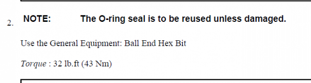

I'm changing my Fiesta SE's automatic transmission fluid. I'm using the Chilton Library guides but I can't for the life of me find out what the actual capacity of the transmission is and what the torque values is for the bolts. I'm starting to assume that Chilton guides aren't the best. I was wondering if anyone knows the torques and capacity? And if people have a better service manual I can buy somewhere, please let me know!

I have the shop manual....I will look it up and get back to you later this morning.

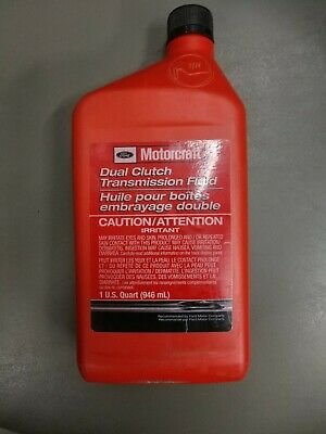

I had to look up the capacity of the Powershift transmission. It is 1.8 quarts.
The fluid part number is Motorcraft # XT-11-QDC.
There are probably other brands of fluid that meet s-l400.jpg the specs. But i don't know what they are.
