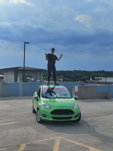

Greetings y’all, Jack and I’m the unfortunate owner of a ‘14 fiesta in titanium trim. Don’t get me wrong she’s quite the car and I’ll drive it till it blows up or I die in it. My fiesta is an envy green hatch back with a manual transmission and has had a myriad of parts and upgrades put on and even more work done to it
  • Custom long tube high output header
  • Full mustang 5.0 performance catback exhaust converted to an axle-over
  • Fully built Ford performance clutch
  • Bulletproof built transmission currently running a 4.10:1 ratio
  • Stock 16in aluminum wheels
  • Trimmed interior
  • Random here and there things that I forget

Welcome to the forum. Please post a few pictures of your Fiesta!

seems like all you need is a dyno and a remap ,I dig that green lime color , don't see many around here
