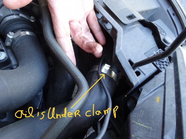

I discovered my 2014 SE with a 1.0 3 cylinder has some oil seeping out at a hose. The picture attached shows where I found the oil. If you can't tell from the picture it's in the right front corner of the engine compartment. Has anyone had this problem? It looks like it's going into a cooler in front of the radiator.

Yes the front goes into the intercooler.

A little oil in the hose is normal. It's from the turbo bearing. I'd clean it up and make sure the hoses are all properly clamped. If there's a lot of oil, your turbo may be wearing out.
If it's running fine, just keep driving it.

That's good to know. I took it off from the bottom and only a drip came out so I'll take that as normal. Thank you for the info.
