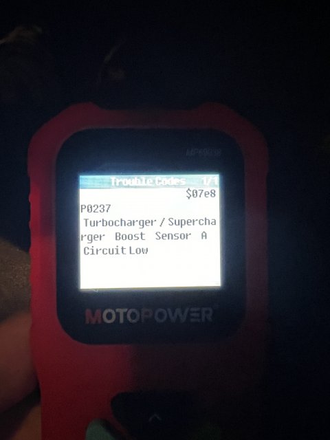

OBD code: P0237 “turbocharger/supercharger boost sensor A circuit low”

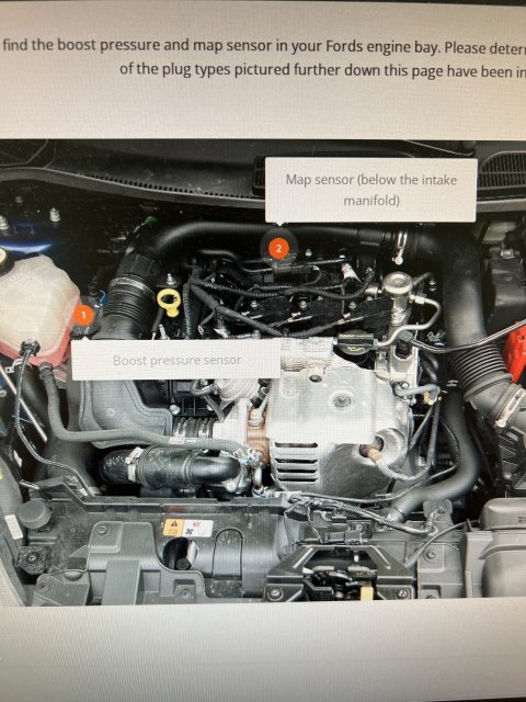

The fault code is always the one above. I changed the MAP sensor and what I thought was the boost sensor. (See photo below) But this did not work. I’ve done a full service with oil, filter, air filter, spark plugs, pollen filter, full coolant change, but with no joy. I took it to the local garage again, they couldn’t work it out either and said bring it back once it does it again and charged me £90. 🤣
Just to clarify, inbetween these episodes the car drives perfectly. Lots of power, normal idle. In the normal temperature range and coolant level isn’t going down.
I will attach a photo of the fault code. And the sensors I replaced. I’ll also add a video link. Any help appreciated.

The issue of A Circuit Low usually tells me the sensor used to determine the boost or regular/normally aspirated and the difference between - that sensor is in the intake pipe.
For it to get damaged, or the wiring to it, usually means something struck the lower cool air intercooler pipe (heat) ex-changer - it means you'll have to test the connector for this sensor - at the sensor - to see if it can send a voltage and if possible, please test the connector installed on the sensor also - to see if the voltage the ECM is sending to it - is not dropping to zero - which if that was the case, the sensor got whacked and you'll need to put a new one on, simply drop in a new one - and retest the connector installed on it again to see if the sensor is properly wired in.

Thanks for the reply. Is the sensor you talk about on the intake pipe the one labelled “boost sensor” on the picture above?
I’ve just bought a multimeter off Amazon and waiting for it to be delivered. I’ll get checking once it’s arrived.

Since he's already replaced the MAP sensor, the other one in the pipe is the one that needs to be checked that it's getting and using a voltage (a variable output reference) the PCM can see to adjust Air to Fuel ratio (an anticipatory event) - that it is variable (as a result) as you move the throttle - else it will go into a limp mode and or if not already - stay in that limp mode until that code is cleared.
