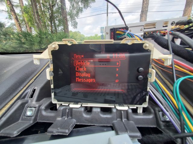

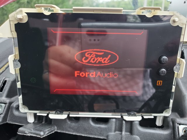

My radio quit working the other day and the screen only displays the Ford logo. I checked the fuse and it is good. I disconnected the battery for 5 minutes and no change. Before the battery disconnect there was no response at all, now the radio unit will eject a CD, and the menu button works but nothing else.
No response to Radio, Aux, or Phone buttons. No Media menu, Bluetooth or anything else...just a basic menu.
I tried installing an Android unit but it is not responding either.
I just don't know what I am missing.....

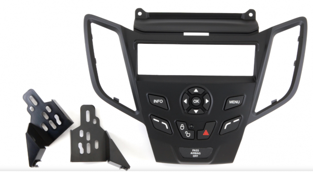

So theoretically, if I sourced a single DIN replacement unit, although less fancy (at least i got an alpine i may be able to slap in there. still new in the box.) it would stand a greater chance of my not having to hack away behind the dash?
I've seen some products that appear to leave the APIM message display alone, using single DIN radios. Sorry for my thick skull here but to be clear, if i did this I can take the existing audio head in the car right out.
2,019
1,399
Yes, your "single DIN" keypad is replaced - you have the "OK" button and it's cursor, you'll have the LOCK and the Warning Flasher (Hazard) button too. But the memory select program feature will not work - you won't get FORD Audio menu either, it will just sit there displaying the TIME DATE and any specific immediate attention messages aside from what you get from accessing the "MENU" which gets cumbersome for you have to use OK to bring it up and you'll use the cursory keypad around the OK to navigate to the feature and it's line by line toggles.
You can get to Sounds on the MENU, but that might not even display - so your radio then takes over the Audio and acts like an ordinary old-time radio with it's own controls and EQ functions.
Many of the APIM functions looped to it and back to the APIM - so it won't see the loop anymore so the RADIO is wired in like it's taking over the Speakers - it'll need power and it will need to supply power to the Antenna - so those have to be "patched in".
Else aside from the antenna - the Radio will complete the install but just doesn't have anything to do with Ford Audio.
I went to "Crutchfields" and found a PDF - this is the "instructions" for the install - The instructions describe a LEARN for the systems with SYNC and then another without SYNC - they tell you to press MENU to change the method in which it communicates. For with SYNC, it used the APIM as only a display - the "calculations'" for Volume and EQ and many other functions - SYNC handled it. So that changed the way the "loop" worked
