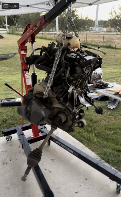

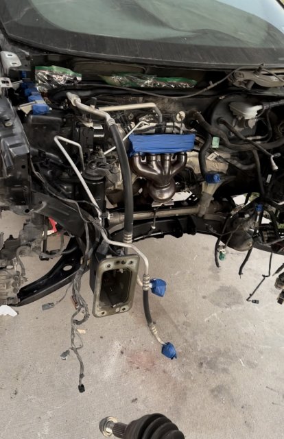

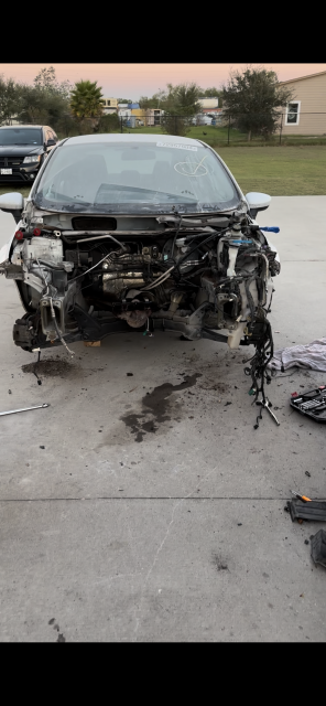

Well here’s an update on it. I picked the car up Tuesday & did the swap when I made it back and yesterday. Everything moved over pretty easy. Ended removing the whole front bumper/radiator support where it bolts to the frame. Kept the cv’s in and dropped the control arm out of the knuckle and was able to pick and move the engine and transmission together with no issues. Gotta figure out the 2 connectors on the clutch pedal and the one on the transmission. Oh ya and I decided to drop the hydraulic clutch hose retainer clip down into the frame haha. Fml. Also, need to swap bcm’s, lock cylinders in doors, ignition cylinder, and whatever other miscellaneous things that are in better condition than what I have at the moment. I need to figure out where the rf hub for the remote keyless entry is at as well. I eventually would like to upgrade to proximity entry and push/remote start but that’ll be a ways out.
If anyone has a lead on a thread I can find wiring diagrams for both the 2012 “se automatic” and the “s sedan manual” would be greatly appreciated. I need to figure out the those connectors and where they pin out to either the bcm or pcm. Thank you guys!
