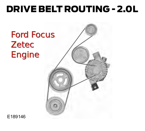

Back when (before while the car was in production) they tried ways to delete it. They found one idea that worked, but it required you use an idler roller they had used on the Zetec motor used on the Focus to take the place of the AC pulley was, with smaller length belt size to offset the changes the new smaller pulley made.

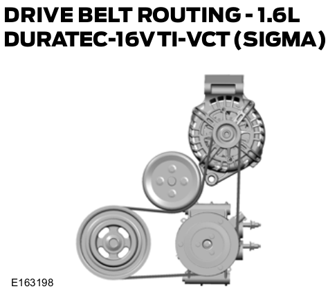

But, that does not help you when the Water pump, Alternator and AC have to be in the alignment and position they are on the Sigma motor the Fiestas' used past 2011-12 model year (USA). Due to their pulley to belt travel - you don't have much to work with...
Aside from the fact that the Alternator by position alone interferes with pulley to belt travel due to the water pumps location when you try to remove the AC.
On the Scion, the AC appears as the "Add-on" so they simply stuck it as the base of the motor over by the oil pan level - the Sigma motor does the same - but the water pump pulley interferes by size (diameter) to accomplish this delete thing which requires you to use the idler pulley from an older Focus Zetec motor they put in there to accomplish the clearance - only they did relocate the Alternator as a swap to replace the ilder on the Sigma motor..
