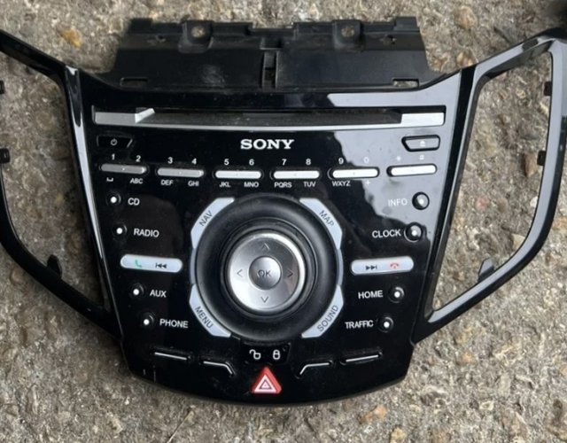

Hi!
I have been having some issues with the stereo in my car. I have a 2011 titanium which when I bought it has a Sony stereo.
About 5 months ago the stereo buttons became very intermittent everything worked on it (the radio, cd player, aux etc) it was just the buttons but the buttons have completely stopped working all together
I have been to a couple of places asking for advise but no one seems to be able to help me
I would like to know what this sounds like for example if I just need to replace the fascia or I need to look more in to it that? Fuses etc. or if there is a way to fit something completely different for example like a touch screen display or is nothing compatible with this car?
Anyone help would be very very appreciated. Thank you!

Mine doesnt look like either of these really. my one looks like this

The front panel or fascia may be faulty but to know that requires to obtain another one from a junkyard or third party supplier (eBay - UGH!) to verify. However - even then the Audio head unit (that amp inside the box behind the fascia) may have failed and it may not be the keypad, but the translation matrix (best word) that the keypad fascia is a part of - has quit working being it's in the AMP or in the SYNC unit support for it.
