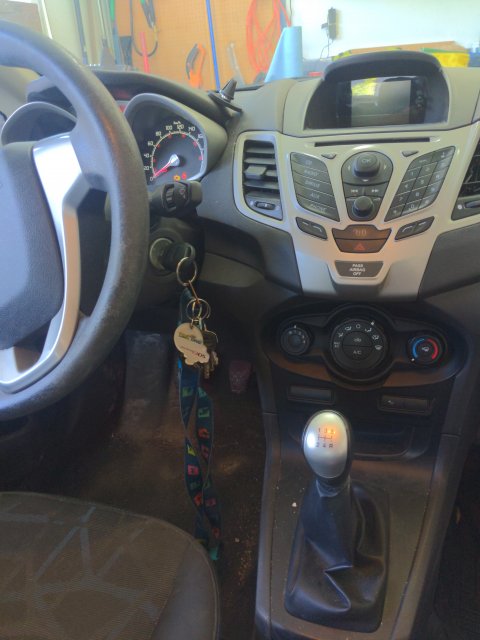

Hi that's alot of words that I don't understand. But at the moment if you look at the picture my display isn't even coming on its just a black screen so I'm pretty sure my hole entertainment system is just not getting any power. (The usb and 12v don't seem to charge anything either)

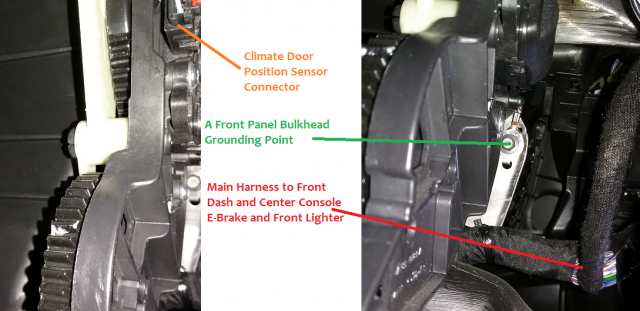

Here's a little backstory, had to chase down a quirky click-click noise after getting car back from Servicing - had a constant noise all speeds, no matter what I do - until I shut off the cars' ignition.
I found it to be a goofy position sensor ... just had to remove it, - apply power to climate control to move the position rotor to a spot on the controller, then reset the controller back to "O" (Off) position and watched this sensor and rotor operate - did this several times to find it's "Parked" position then re-seated the sensor back in to the correctly repositioned "cog" and now the heater and climate work fine.
Here's a internal view from the Accelerator pedal - upwards into the Center Console - behind the dash - view.
This is why I think there may be more of a loose wire or connector then a bad keypad, but if the keypad is bad, no matter what it will cost you to replace the unit as one-whole piece. You have nothing to lose by trying to find the harnesses and look for loose connectors - the worse case scenario is to fix the whole mess with a new dash - unless the problem is taken care of ...
