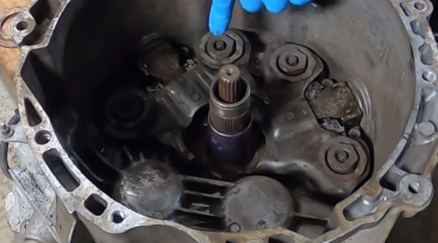

Ok, not sure if you have the type of "reflash" they did to make the TCM performance quirks fix - there's several recall "issues" so it's kind of hard to hit which one your car would fall under - one is the TCM another if the bad transmission recall - both they reprogram the profile to help with issues.
But in many worlds of that TCM and the problems and drama it causes... - the main problem I see in the older units - can be best described in this video...
Look or watch Here
The premise is the "build up" of the clutch media - it gets trapped inside the housing - and simply cakes on - by heat, moisture and lack of ventilation. This includes - the wearing of the clutch pack, the disc material and the sheer volume of it. generates a range of motion - or throw - set of problems. This also does not address the electrical side of this - but replacement of the clutches and solenoids, works to a degree, but the ENTIRE housing needs a good rinsing out to remove that build-up debris and metal shards from the grinding-away this things faithfully deals with - everyday.
The TCM tries to "auto-range" on a regular basis as a means of self-check - but that does also mean that it may or may not complete the full-range of motion cycle - and generate a condition or two that if left to itself can self-destruct the transmission on it's own. Hence the recall.
So can you - if possible - dig down into that sleeve and clutch assembly and locate those shifter forks and see if the throw (slide sleeve) is blocked or not able to be done smoothly - then the transmission should be swapped out - it's throw-out bearing and the shaft it rides on, might be out of tolerance and grooved as such to generate a hit or error and if too many of them happen, the TCM's own realms of codes get set - you're experiencing this now...

Looks like the TCM Pooped itself. I got it to run after disconnecting battery, forward gears and reverse perfectly fine, then I parked it and shut it off now I’m seeing all sorts of codes and it won’t even crank now.
