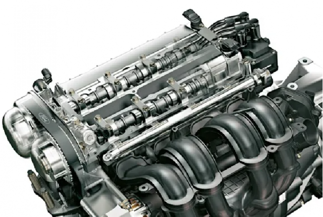

To help - the above is a "Cut away" of the cams display of a 4-cylinder 1.6L they use in our Fiestas.
The "root" is Sigma - then moved to Duratec (goes by those names including others)
The "Tapping"? You're not alone - I too, being a delivery driver, our fleet we use Ford - including Fiestas.
The startup and running especially in the Morning - these things are noisy tapping rattle that can be heard across our parking lot. It's due to the wear of the cam lobe to follower clearance that moves the valves as they follow the cam.
We use 5W-20 in various blends so the noise doesn't go away - it's a clearance issue - so either you rebuild the upper cylinder head or just live with it.

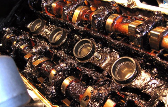

That the "black crud" you speak of, usually indicates low-heat, short trips with little start-stop traffic.
That may be more of a self-perpetuating demon that kills engines - it's called short trip.
Rich fuel mixtures are needed when a vehicle is first started up - so that alone can generate a lot of soot and dilute oil because the unburned fuel and soot reduce the oils effectiveness as being a lubricant - even though it has detergents and suspension qualities - that does little good if the particles can't get trapped in the oil filter or removed thru the tailpipe - or worse they do get removed, but plug up the filter media and reduce it's ability to flow a given volume of oil the engine needs for every revolution it makes.
In using todays oil formulations this "crud" is less likely when the engine is driven even for only a 10 minute short trip to and from work. So this tells me that there may be some thermal or short trip drives that - show you how the motor slowly dies a carbonized sooty death from the build up - a lot like a smoker that when you're behind them in traffic, you can easily see (and smell) their habit(s) are well underway.
It is also sad to see the condition of the vehicle, (the photo above) in some cases; the habit takes precedence more than the maintenance of the vehicle.
