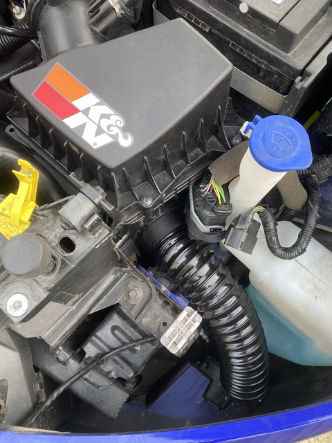

This is what I’ve been using for about three years. I’ve shortened twice and am pleased with how it performs. I didn’t care for the modified air box as I feel it still limits intake. I know we’re not pulling air to feed 500+hp, but this will flow more than enough without noticeable affect from engine bay heat.

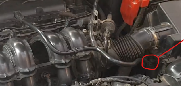

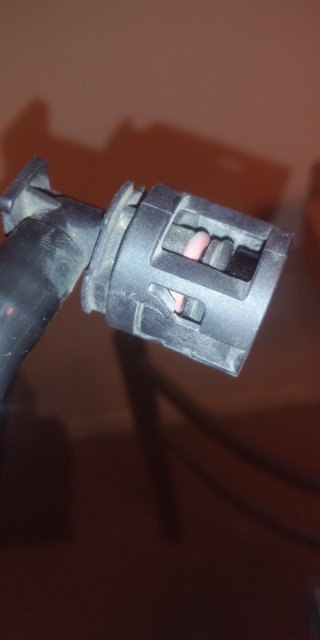

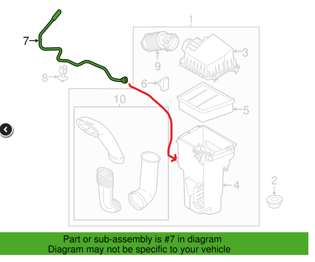

How do you get this little bastard to let go of the airbox (hose comes from the cam cover)? I fiddled for 15 minutes, but didn't want to break it. Must be a decoder ring somewhere?

I don’t remember exactly, but I don’t believe it was difficult. I spent more time shortening the intake tubing. Lol

Gonna pull the whole box out with the tube attached and see if I can get it off on the bench. Maybe then I get a good grip on it.

Ok ok...you gotta pull back on the ring...its like a air compresser or power washer attachment.

Show off!!!! Did you just pull or did the collar have to be pulled back?
735
956
Thread Starter #13
Right on...I tried that but with only one hand I couldn't get it...I will try again Weds or this weekend.
