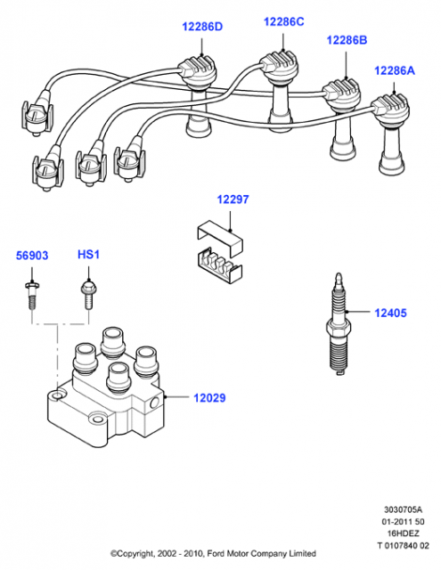

Also, does it look like the part marked 56903? to mount the coil pack?

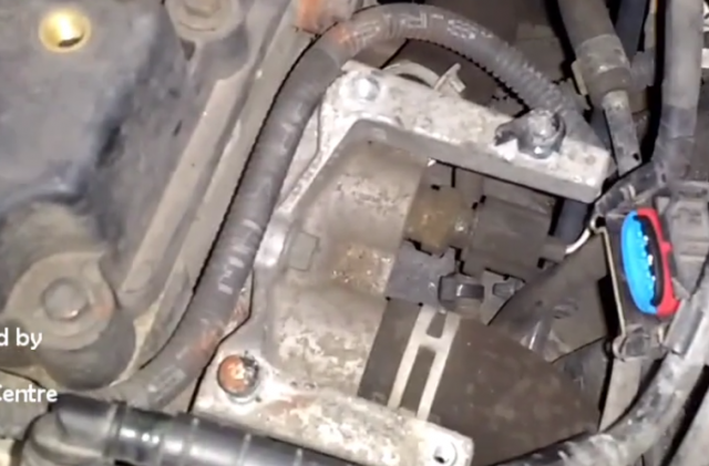

In the above YT shot the older HEX bolts are seized and so the plastic broke off from the case.
YT link here...
This was all done due to issues of seizing of the bolt to the cylinder head flange that stuck out the side of the cylinder head for mounting and tapped to fit those bolts, sometimes they can be reused but due to the dissimilar metal galvanic corrosion issue, they came up with a plated and coated bolts to replace them.
Product Specifications
Brand Genuine Ford
Base No. 56903
Manufacturer Part Number CM5Z-00813-B
Part Description Screw
Other Names Ignition Coil Screw
Manufacturer Note M5 x 25MM
Item Weight 0.50 Pounds
Condition New
Fitment Type Direct Replacement
Replaces CM5Z-813-B
Require Quantity 4
Manufacturer Ford
SKU CM5Z-00813-B
